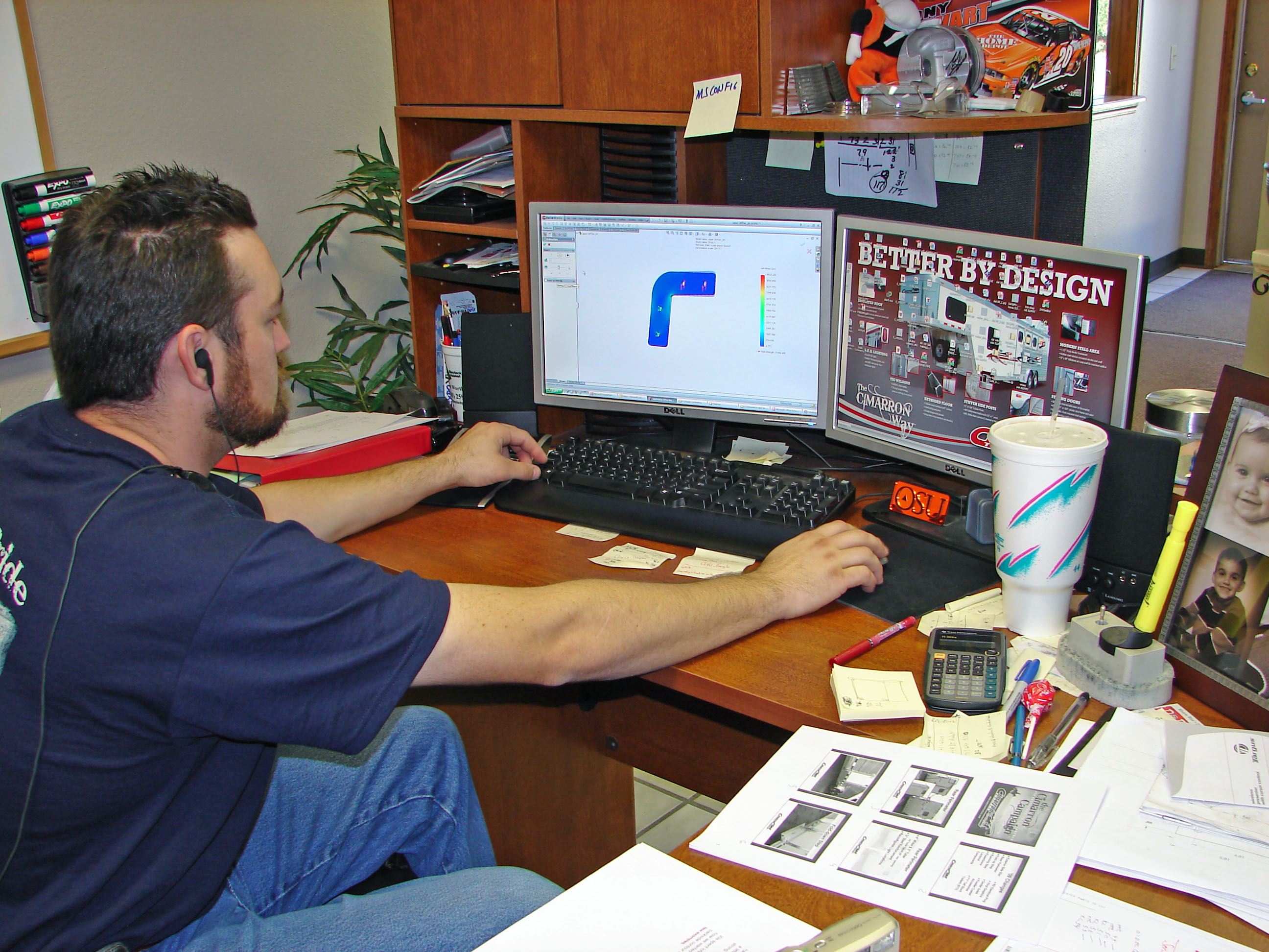

Andy, the engineer using a 3D computer program can stress test components, speeding up improvements and strength in Cimarron trailers. Engineering changes such as steel rear corner boomerang, allows narrower corner post for a wider stronger door opening.
Computer engineering allows 4" wider and 2" taller door, Huck bolts not welding the 1/4" plate boomerang gusset, is stronger than typical welded fishplate.

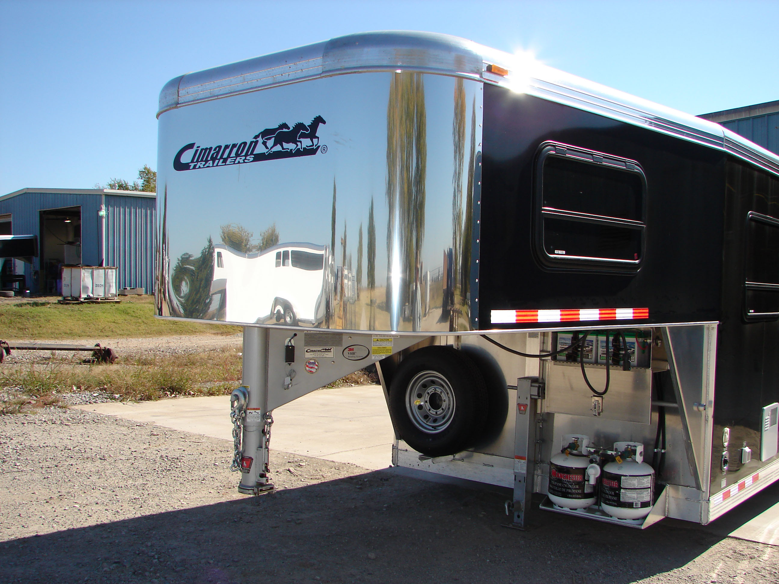

Look at the siding and smooth aluminum skin attached with 3M VHB Tapes. radius rocker panels finish the trailer neck.
18" radius nose, safety bar grills, 34" hip windows, lots of them.
