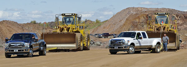

Towing Cat 988 loaders (85,000 lb) with F350's

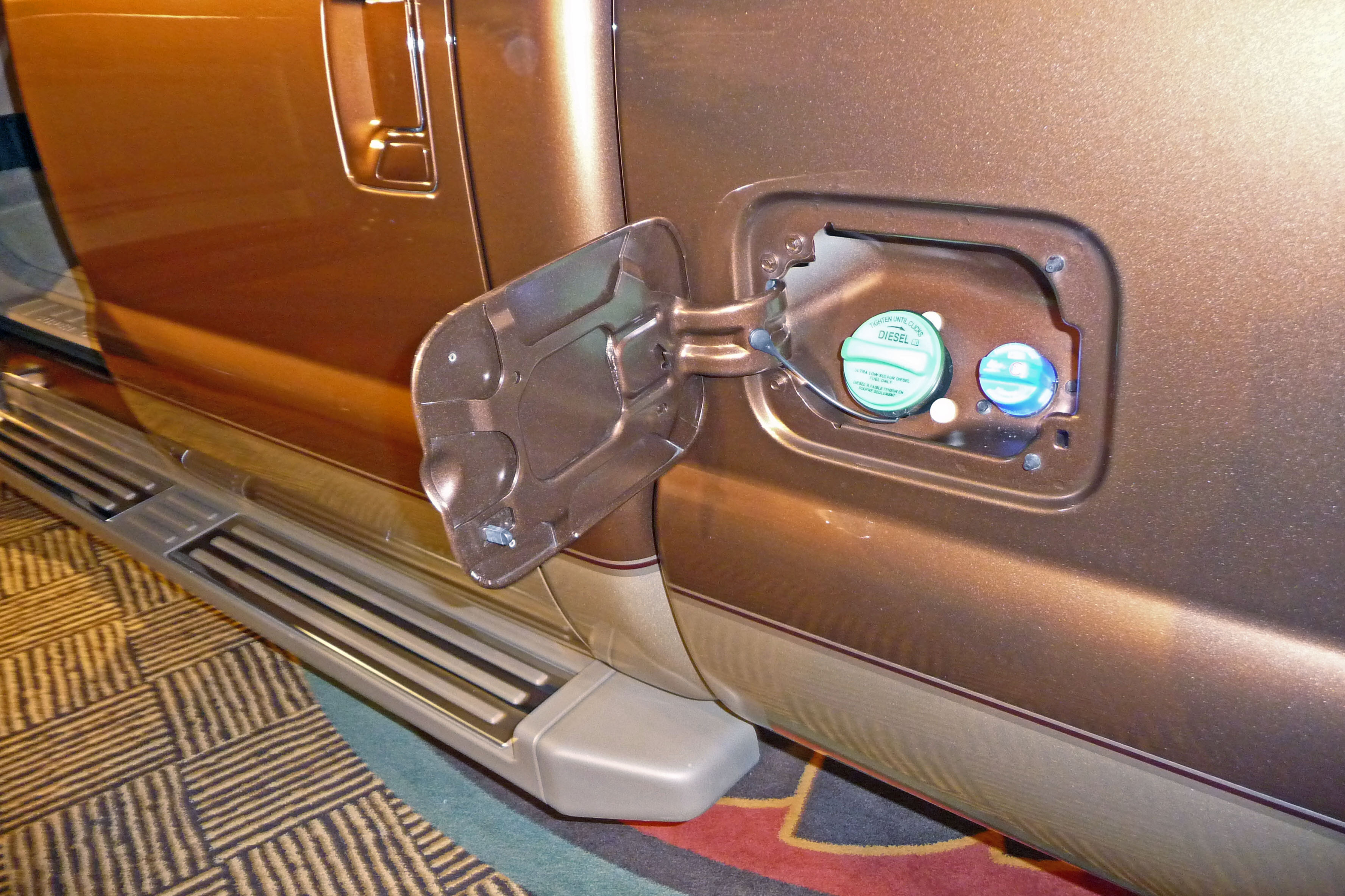

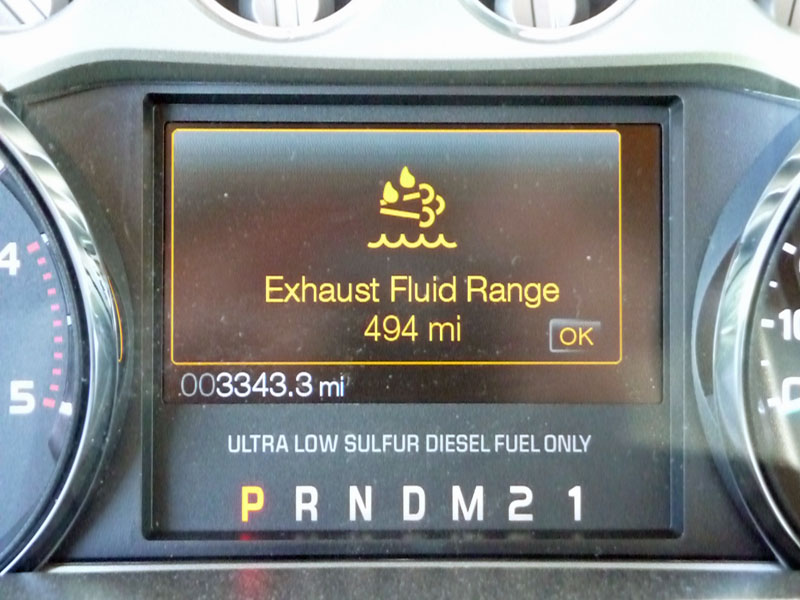

Service: Back to a 2 quart spin on oil filter. This is less mess than the cartridge 1 quart filter Ford has used since 2003.  In the pan, transmission filter good is for 150,000 miles of severe duty with a special dual media sump screen. The new Diesel Exhaust Fluid (urea) for the new 2010 lower federal emission standard Nox rating, is filled next to the diesel cap in the bigger fuel door. Super Duties hold 5.6 gallons, 6.3 on a Cab & Chassis model. The 4.2 LCD Productivity screen displays warnings when you need to add more DEF. Still dual fuel filters on the new diesel with a water drain on the primary fuel filter inside the drivers side frame. The engine oil drain plug is unique, no more taking the plug out or dropping it in the old oil, just insert a ratchet and a 1/4 turn on the plug.

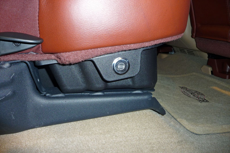

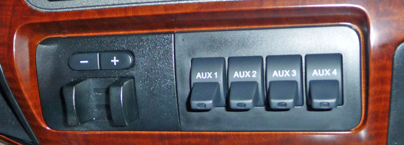

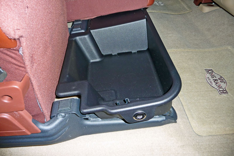

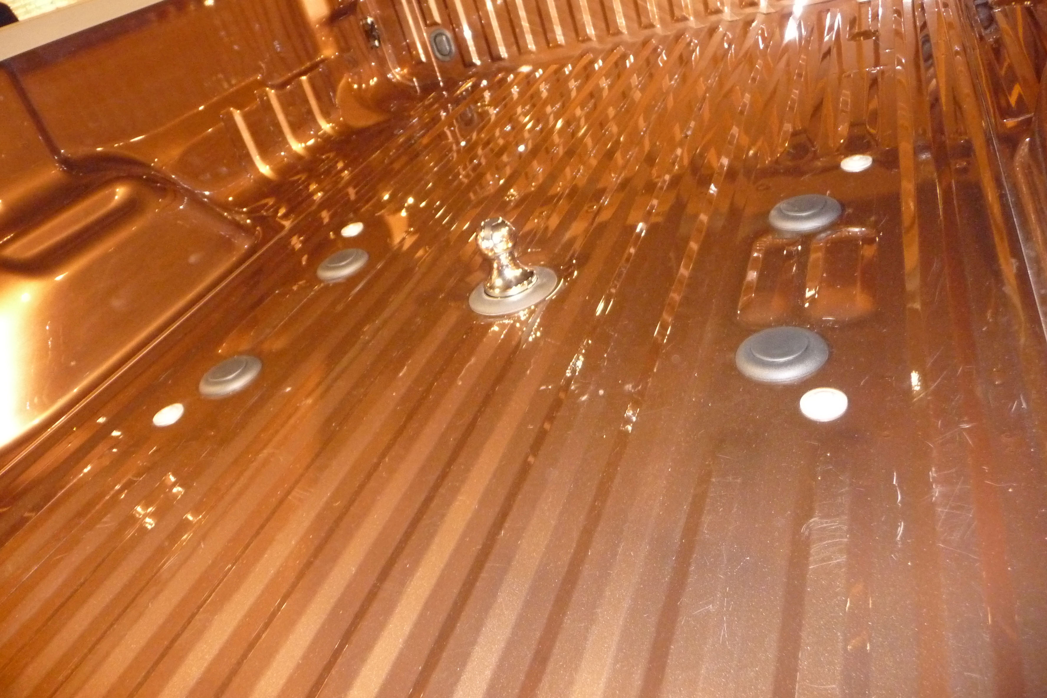

Brake controller, now for hydraulic trailer brakes, control center records facts for different trailersRear seat locking storage ...divider comes out and you can store the rifles  New factory gooseneck ball and setup for 5th wheel

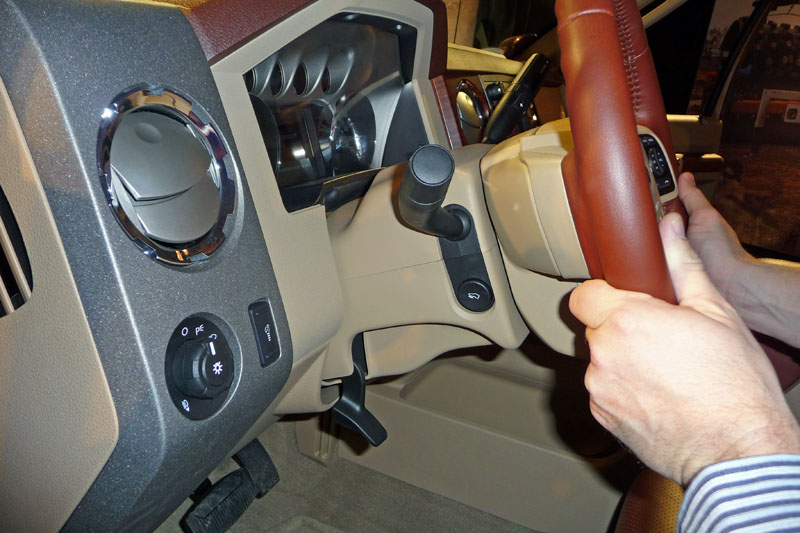

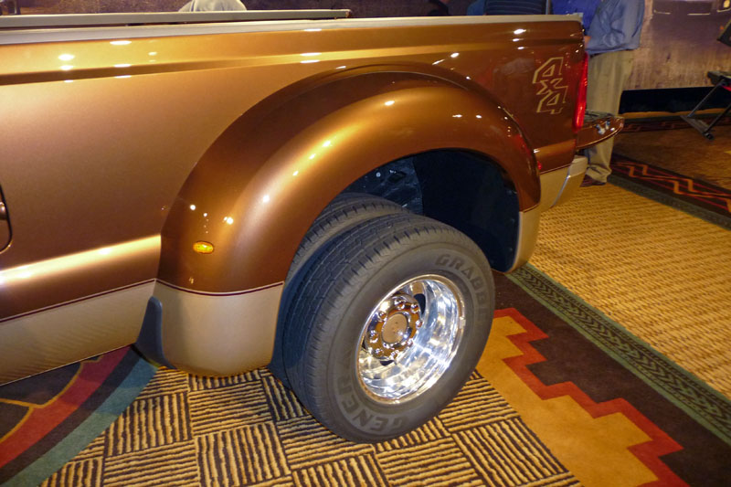

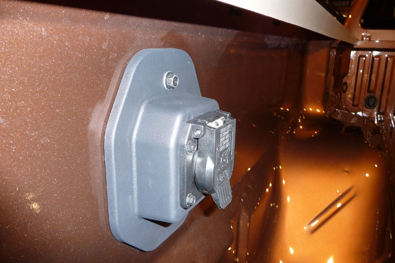

Trailer plug inside the bedTelescoping steering wheel, I love it !Big fuel door for diesel and urea, I mean DEFDodge got away from the round bolt on dually fender, so Ford picked it up

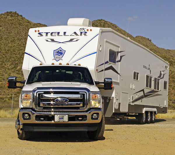

 Towed 24,000 lb trailers in Arizona
